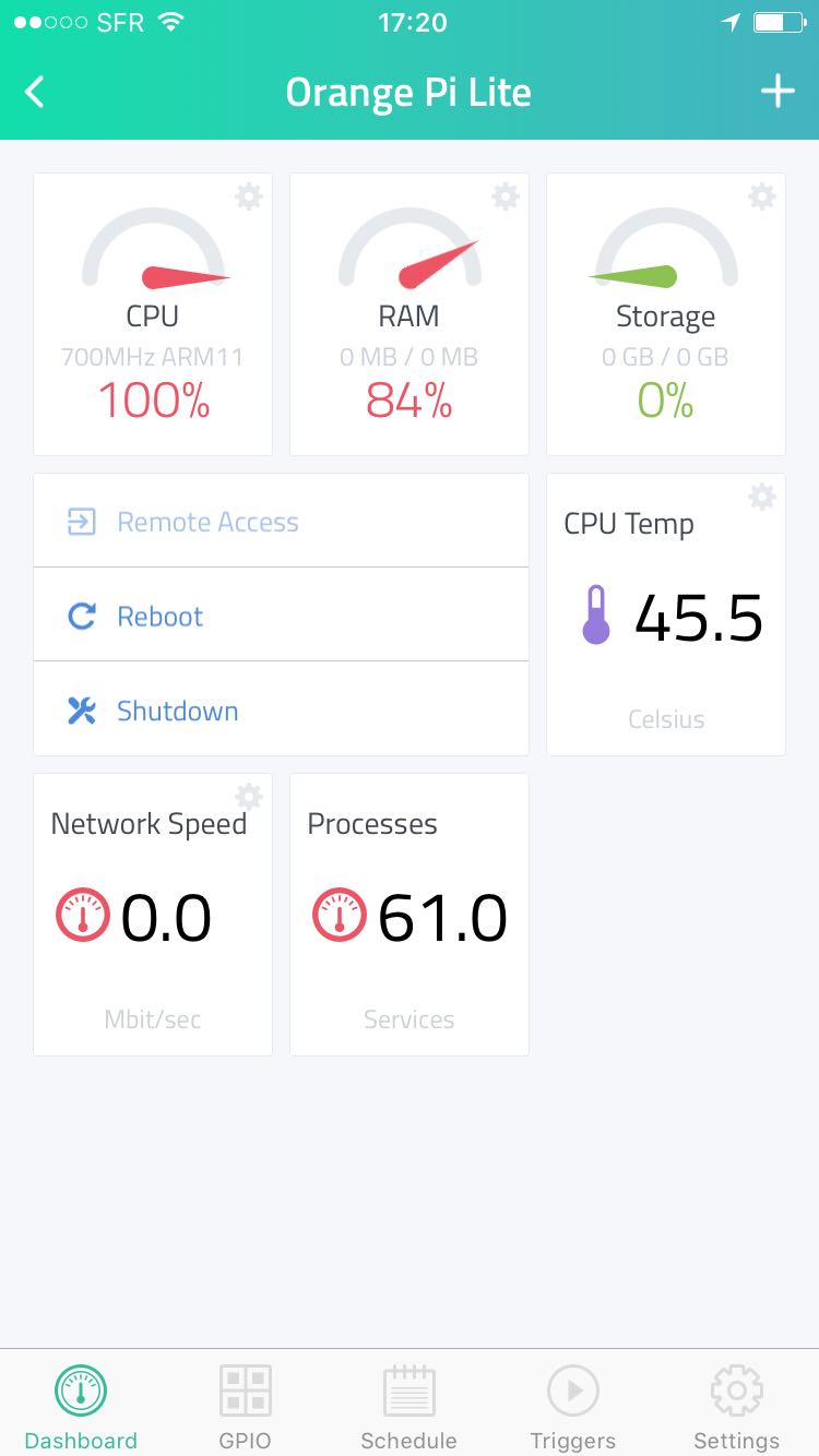

Is there a predict to launch for Orange Pi Plus 2? I installed on my Orange Pi plus 2. It goes on line but with no GPIOs and all gauges (memory, cpu, etc) are dead.

Hi, it worked properly your “orange pi” ?
worked. but not visible cpu temp & network speed
