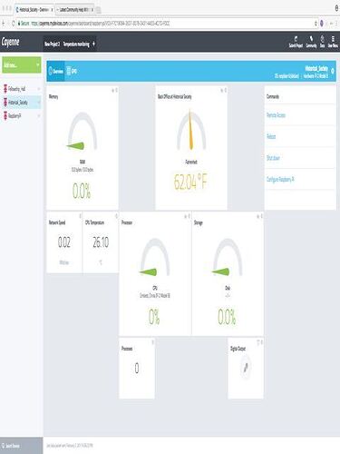

I have three pi’s that I use to monitor temperatures in three buildings using DS18B20 sensors. Two of the installations are completely trouble free and the third keeps dropping the connection to myDevices. Usually a simple power cycle of the pi restores the connection. Sometimes it may go a week, other times only an hour or two. All are wifi connected to the internet, the troublesome one likely has the weakest connection. The troublesome one is also a pi2 whereas the other two are pi3’s. Today, the situation is a little different. The troublesome pi shows that it is on line in both the web interface and in the Cayenne App but the widgets show 0% and the temperature is stuck at 62.04F. If I try rebooting remotely nothing happens. It is like the pi is offline but indications are that it is on line.

I have reset the dashboard with no effect. That particular unit, i don’t have remote access into so can’t reboot via ssh. I can click the reboot button on the web interface, then confirm in the box that pops up, but there is no sign that it is rebooting. Again, all indications in the web interace are that the pi is on line but there appears to be no communication with it. Still says that the room temp is 62.04F.
I’d say that it’s lost communication with Cayenne, despite the dashboard not showing the yellow “last seen” banner that it typically shows for an offline device. If the gauges aren’t updating and the remote commands aren’t working either, we’ve effectively lost communication with it.
