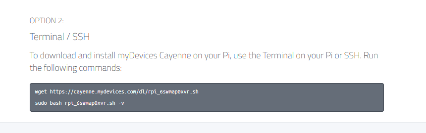

Log in to your dashboard on a computer, click Add New>Device/Widget>Raspberry Pi then the command will be shown in option 2 (don’t use the code in my screen shot, yours will be unique to you)
It never gets to the dashboard, so I copied the lines from the intro screen after logging on.
