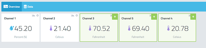

this code works for me without any problem. it is currently using a single DHT22, is if it works for you.
This example shows how to connect to Cayenne using an Ethernet W5100 shield and send/receive sample data.
The CayenneMQTT Library is required to run this sketch. If you have not already done so you can install it from the Arduino IDE Library Manager.
Steps:
1. Set the Cayenne authentication info to match the authentication info from the Dashboard.
2. Compile and upload the sketch.
3. A temporary widget will be automatically generated in the Cayenne Dashboard. To make the widget permanent click the plus sign on the widget.
#define CAYENNE_DEBUG       // Uncomment to show debug messages
#define CAYENNE_PRINT Serial  // Comment this out to disable prints and save space
#include <CayenneMQTTEthernet.h>
//DTH
#include "DHT.h"
#define DHTPIN 2
#define DHTTYPE DHT22
DHT dht(DHTPIN, DHTTYPE);
#define DTH_hum_Virtual_Channel 1
#define DTH_tempC_Virtual_Channel 2
#define DTH_tempF_Virtual_Channel 3

I was able to duplicate (only partially) the reading of the second dht. Below the screen shot of my dashboard and then that of the serial monitor.
I have not yet figured out which widgets I need to insert and how to connect them to the second dht.
I tried to copy the settings of the widgets that appeared automatically in the dashboard, but I did not understand anything :slight_smile:

[820439] Publish: topic 1, channel 4, value 20.776, subkey c, key temp
[821519] Connection ok
Humidity: 43.10 % Temperature: 21.20 *C 70.16 *F Heat index: 20.50 *C 68.90 *F
[830852] Publish: topic 1, channel 1, value 43.100, subkey p, key rel_hum
[830930] Publish: topic 1, channel 2, value 21.200, subkey c, key temp
[831005] Publish: topic 1, channel 3, value 70.160, subkey f, key temp
[831080] Publish: topic 1, channel 5, value 68.902, subkey f, key temp
[831156] Publish: topic 1, channel 4, value 20.501, subkey c, key temp
Humidity2: 45.20 % Temperature2: 21.40 *C 70.52 *F Heat index: 20.78 *C 69.40 *F
[831520] Publish: topic 1, channel 1, value 45.200, subkey p, key rel_hum
[831600] Publish: topic 1, channel 2, value 21.400, subkey c, key temp
[831675] Publish: topic 1, channel 3, value 70.520, subkey f, key temp
[831750] Publish: topic 1, channel 5, value 69.396, subkey f, key temp
[831824] Publish: topic 1, channel 4, value 20.776, subkey c, key temp
[832904] Connection ok
