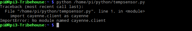

with the new script i get this error message:
I start the command with sudo python3
I was able to get rid of the error message using
sudo pip install cayenne-mqtt
The DHT22 seam to be Online but there are no widgets in the menu
Can you try sudo pip3 install cayenne-mqtt
and then run the file with sudo python3 filename.py

When I try to run my code with sudo python myfile.py I get the same error as you:
Traceback (most recent call last):
File "dht11.py", line 1, in <module>
import cayenne.client as cayenne
ImportError: No module named cayenne.client
I think that it is because I install cayenne-mqtt using python3.
Can you run sudo apt-get install python3-pip
We have Liftoff!![]()
sudo python2 /home/pi/python/tempsensor.py
Seams to work, but unfortunatly i get some Reading-error.
but this might be because of the 3-4Meter Cable I`m using.
is already installed
