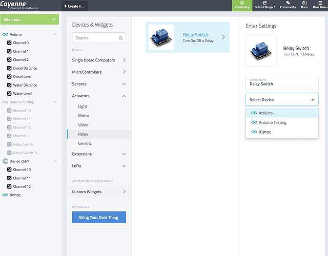

Hello Benny, i followed the transition information. Mobile app required an updated, its ok now. But i am not able to add an Relay-Actuator. I dont know whats the difference when adding a board like arduino, by selecting Bring your own thing or selecting an arduino from the Microcontrollers options. I have tried both solutions. If i choose Bring your own thing option, then custom widget doesnt work as Step:2 Add Widget doesnt work. If i’ll try to add the relay from actuators->Relay or Actuators-Generic, when selecting device, the board is not there, is not showing see picture below although “device25b1” is on network (but is grey, faded).
If i want to add an Actuator->Relay i have to choose only boards imported to Cayenne dashboard without “Bring your own thing” method, see below.

@ufrtgr when a device is added using “Bring your own thing” use a custom button widget.

I think i have replied to that. It doesn’t work. The step2: Add Widget button can not be clicked. Only from mobile i think is possible and only virtual channels. Also the invert logic is no longer there.
@ufrtgr yes we will be fixing this bug soon! Thank you for helping to bring it to our attention!
