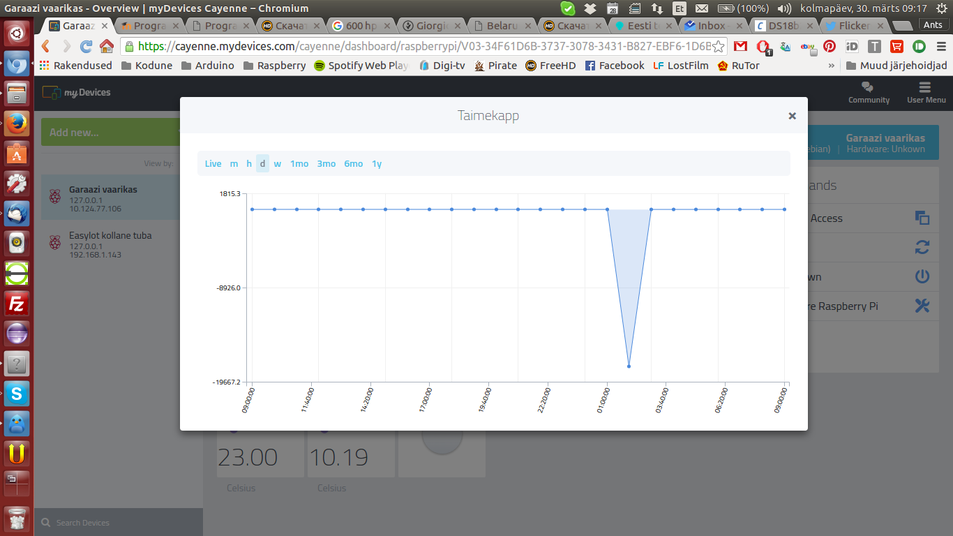

Sensor Taimekapp reads -2147483.65 Celsius. The alert is set to 16 Celsius or lower. This is connected to Garaazi vaarikas.
This error is 1-2 times at 24 hours every day.

The large negative number usually means that there is a mis-wiring of the DS18B20 temperature sensor. Does the dashboard also display the large negative number?
Or does only the alert text have the large negative number?
-B
These large numbers needed filtered out. This is only in day view.
This is maybe from ds18b20 connection. I not solder these.
