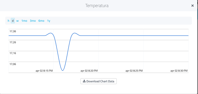

I see that DHT22 value is not stored on graphic, is this a known issue?
I see also that TRIGGERS based on DHT22 value are not working, is this a known issue?
Same issue for me, i see temperature and humidity value but no data are stored for the graph :frowning:
Graphs for MQTT Devices are not supported, yet
I think they are supported, mine is working:
Oh, you`re right…didnt know that. Sorry for the false information…
as you can see i`m getting lots of false readings…
But every 10-20sec a legit reading comes through…
any idea how to fix it? becouse I have no data stored :frowning:
This night graphs started working…no mod from my side. probably a temporary issue!
some strange reads also for me
I confirm, same situation for me.
