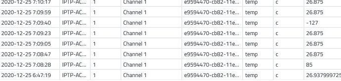

Dear friends: I’m working on my project, that consist in 9 DS18B20 sensors connected to a Lolin32 board. I need to read 9 temperatures at same time.
The problem is that many times it appears the 85 value. I tried everything to avoid bad wiring connections or similar problems, but 85 is still there.
I would prefer to filter the value. I need the 85 value not to be sent to MQTT server (cayenne) but I don’t know how to do it.

Well, tried but didn’t work. I connected a 1.2 k, 1.5k and 1.8 k ohm and the problem remains the same. Any other idea?
Since the resistor didn’t work, try the software again.
if (sensors.getTempC(tempSensorA) != 80 || sensors.getTempC(tempSensorA) != (-127.0)){
  Cayenne.celsiusWrite(DATA_CHANNEL1, sensors.getTempC(tempSensorA));
            many thanks, Adam. It seems to be working!
