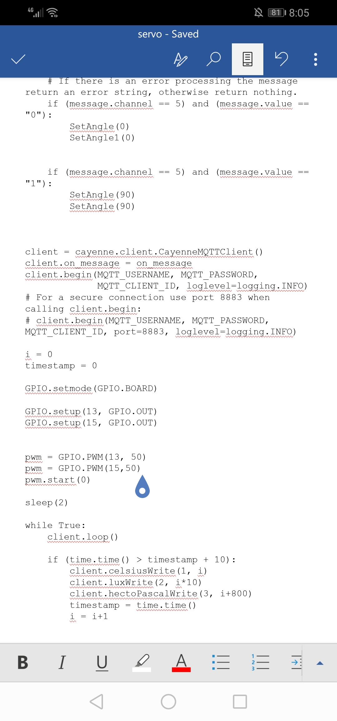

If i put the first servo in gpio 13 and the second servo is in gpio 15 btw im using the board mode. How do i set them?

Is this correct? I dont want to destroy my servo so can you please help me correct it
for value = 1 you have to make change to SetAngle() both are same.

Hi i tried what you had told me but it seems that the servo is confused only one servo turns
what kind of servo are you using. are you powering them both from the raspberry pi?
I had them externally powered
Im using mg996 r
check if you connected them to the right pin
