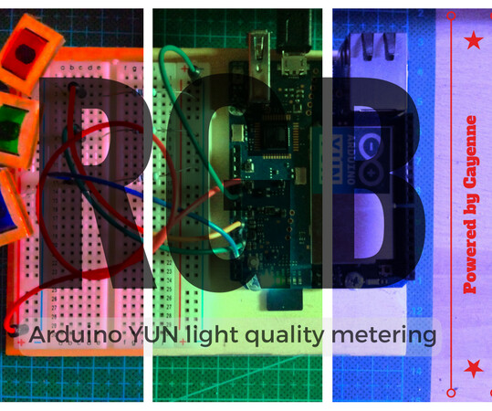

About This Project
This is a project with Arduino YUN and three resistors and three photoresistors. I’ve created this project with Cayenne classic edition, now I have modified this project with MQTT protocol. Each resistor have color filter three photoresistors, three filters: RED, GREEN, BLUE.
When the light hit the photoresistors, the resistence modify his value, and the analogRead of Arduino YUN read a different value like input. You can read the “quality of light” on your Dashboard.
The MQTT it’s a really revolution for me! You can use this protocol on all device that you want! It’ really cool!
What’s Connected
Arduino YUN three photoresistors in series with resistors. See the hardware project to this page:
Dashboard Screenshots
Photos of the Project
