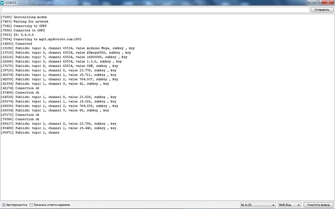

can you share the serial monitor output?
also simplifying the code:-
CAYENNE_IN(3)
ValueL = getValue.asInt();
digitalWrite(Liht, !ValueL);
what do you get in the serial monitor when you press the button the cayenne dashboard?
Nothing.
