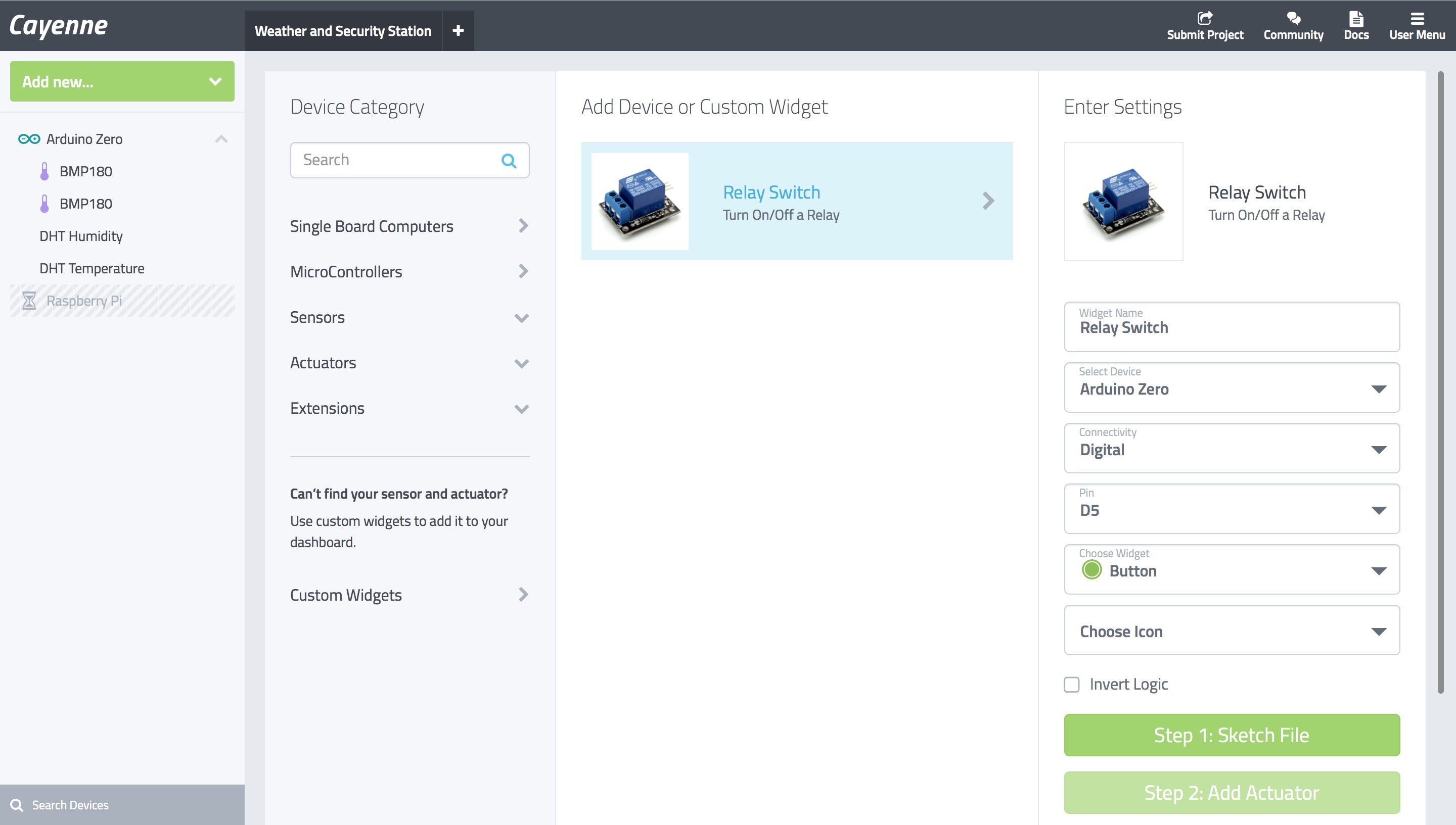

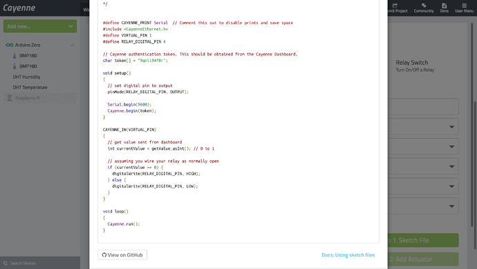

The code was taken from Cayenne. First screen shows the parameters I’ve entered, and second the code generated.

The sketch looks ok to me, what were you expecting to see?
Three things:
  • The generated code includes CayenneEthernet when the connection is handled by CayenneWiFi101.
  • I asked for pin D5 and Cayenne defines RELAY_DIGITAL_PIN 4.
  • Cayenne uses VIRTUAL_PIN 1 which is already used by another widget.
Create another one to complete step the smart home system.
  • I agree it would be nice to have the initial config saved and populated when adding new sensors.
  • I’m not sure why it’s defining RELAY_DIGITAL_PIN 4, it is not needed.
  • VIRTUAL_PIN 1 is created for ease of adding new sensors/actuators. Basically Cayenne sends which pin it should write to the virtual pin and it doesn’t matter if it’s 1-53. In your case for pin 5 it writes the pin when it receives the message >dw50/>dw51 (off/on). You can completely take out the code below and it will still work.

I also agree! We will make update to Cayenne in future, where we can remember what shield you selected, and then make sure to use that shield in the sketch file that we auto populate.
We will fix that file, I don’t quite know why Pin 4 was selected for the relay, but regardless, it can be changed to whatever pin. Great feedback @rei_vilo & @ats1080s !
