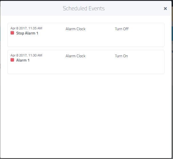

Scheduling
Scheduling ,in this project, is used to trigger a buzzer at a set time to work as an alarm clock.
