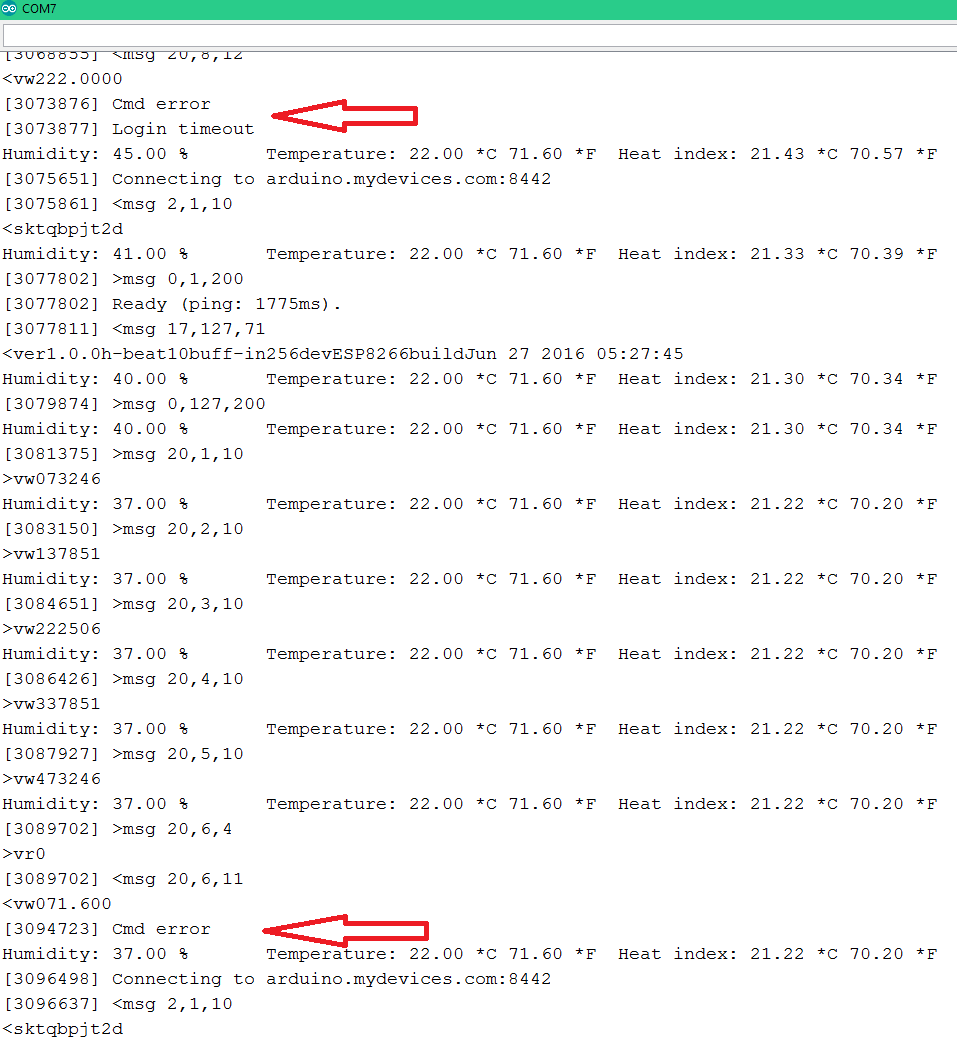

Please describe the bug / issue. Attaching any relevant screenshots would be very helpful!
Rather constant Cmd errror/Login timeout that results in all the V-pins not being polled and written before the next time out. Resulting in higher numbered Vpins never being successfully reported to the server.
I’m sure the problem is with my code, but if it could be a timeout rule that can be extended that might be nice.
The code-

// These functions are called when the Cayenne widget requests data for the Virtual Pin.
CAYENNE_OUT(V0)
Cayenne.virtualWrite(V0, dht.readTemperature(true));
CAYENNE_OUT(V1)
Cayenne.virtualWrite(V1, dht.readHumidity());
CAYENNE_OUT(V2)
Cayenne.virtualWrite(V2, dht.readTemperature());
CAYENNE_OUT(V3)
Cayenne.virtualWrite(V3, dht.readHumidity());
CAYENNE_OUT(V4)
Cayenne.virtualWrite(V4, dht.readTemperature(true));
Note the sporadic placement of the data points in the below graphs. Vpins 3 and 4.
-Ian
