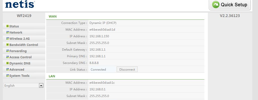

also check that Preferred DNS server
is set to 8.8.8.8
try changing the primary DNS to 8.8.8.8 or interchange both.
as soon as I reset the primary DNS to 8.8.8.8 the new device connected.
then either reprogrammed the arduino with the old program and I lost the connection again.
I reprogrammed the arduino with the new one that first communicated and now no longer connects
did you save the DNS setting? can you check again?
yes the settings are saved, i checked

hold on. First of all terminate and close the MQTT.fx. next check whether the DNS server is 8.8.8.8. delete both device from dashboard. Now add new device on your dashboard and add this client id to the code and upload it to arduino.
