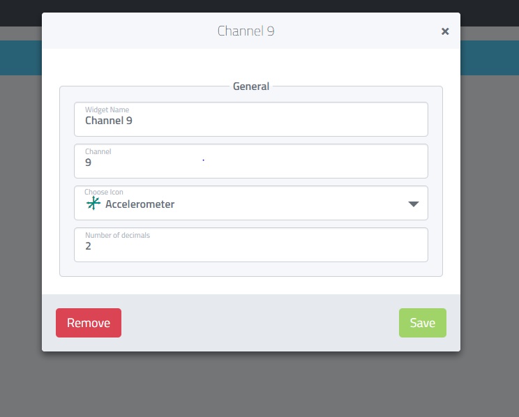

when sending rewrite(…) function on node.js client,
the dashboard shows a general widget, it will be good to:
a.change the general widget to specific widget
b.send in the rawrite the type of widget that should be created

hi @bestes
thnx for the quick reply,
as you can see there is no option to change the widget type (because this widget was created “on the fly”).
my device sent some data from an unknown channel and the widget was created automatically
here is my node js code that I used to send data
cayenneClient.rawWrite(9, 1, “digital”, “d”);
