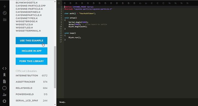

  2. In Particle Coud Editor, search for Cayenne Library
    Select CAYENN-PARTICLE
    Select USE THIS EXAMPLE
    Build and Flash the Code
