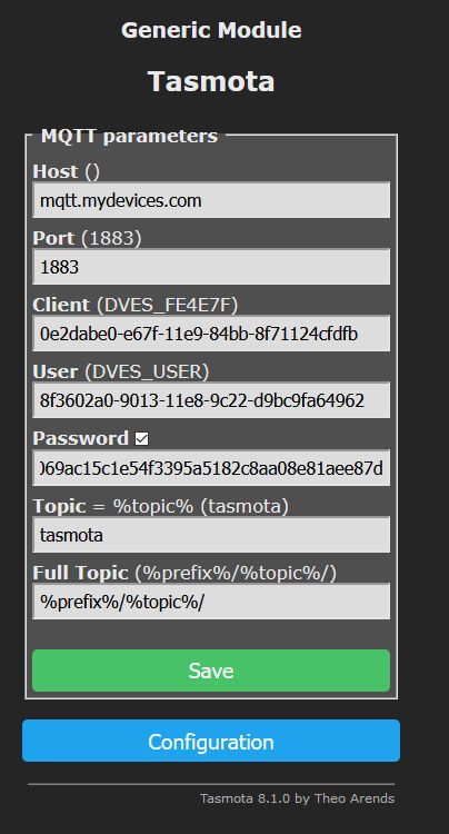

So when I get required data for connection
Chayenne
I add this to Tasmota MQTT settings
And after restart then I got that log from previous message.
As frim that log I understand This client connect to Cayenne for few minutes but is then later disconnected?
BR
Okay. Got it. But from are you getting those topic?
