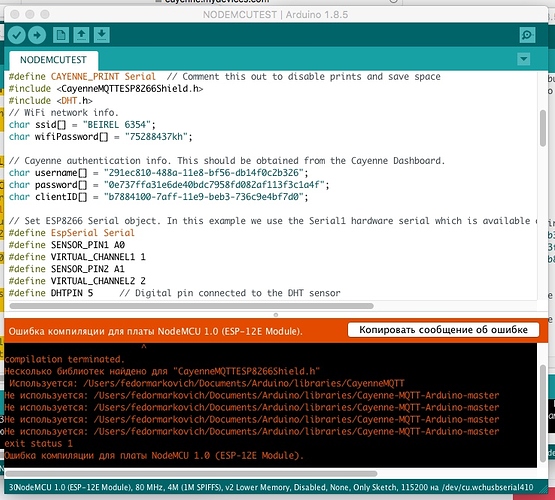

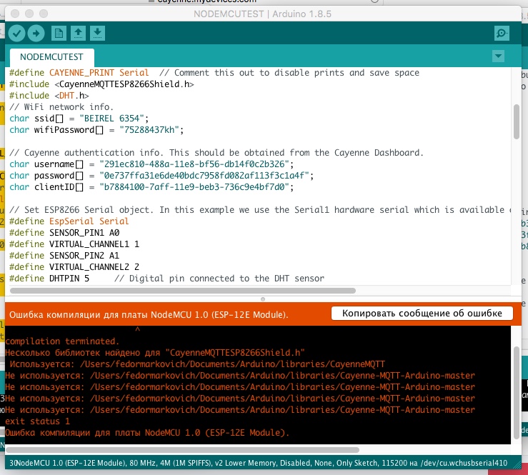

I have problem with NODE MCU. When I bought it, I try to connect it to Cayenne, every thing was working, but now I couldnât upload the code.
I donât wonât to change, I mean if it doesnât work in my country house, but it is working in my apartment in town, maybe its because of some different settings in wifi router?
For nodemcu you need to use different header and code Adding a New Device using MQTT
I done this, same error
may be its because of the version of Arduino ide?
can you share the code you are using now?

this is not the correct code. look at the topic i shared above.

go through the entire topic once again step by step and you will understand your mistake.
Now its working
thank you so much!
