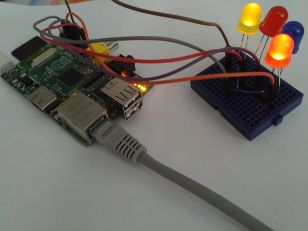

Monitor is in my office and has four LED diode:
Orange - pir sensor is / was up
Red - temperature over 30 degree
Blue - temperature under 15 degree
Yellow - light is / was up
The LED stands light, I can see, that anybody went wrong, when I was not here. Then I can turn the light over Cayenne desktop.

I use for this project two old RaspBerry Pi - for the watchdog station RPi B+ and for the monitor RPi B
Two breadboard
Four LED diode
