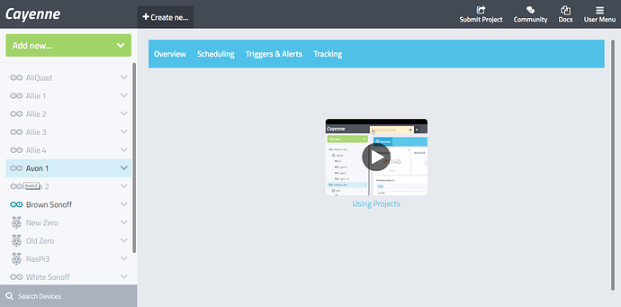

…ALL my PROJECTS are gone-
all my triggers are gone…
the devices are showing up…
I tried clearing my cache, -no good.
but NO actions! BAD fix!
Hi Bill,
As we discussed in our PM, the projects disappearing is known (they are still there, not lost – just not loading) and we’re expecting a fix either today or tomorrow. Apologies for the trouble.
We aren’t aware of anything with triggers going missing, so I wanted to ask about that. Are they still missing if you go to Add New > Trigger > My Triggers, or User Menu > Triggers and Alerts? I would expect them to be missing from any newly created project views since projects aren’t loading, but not from the above areas.
