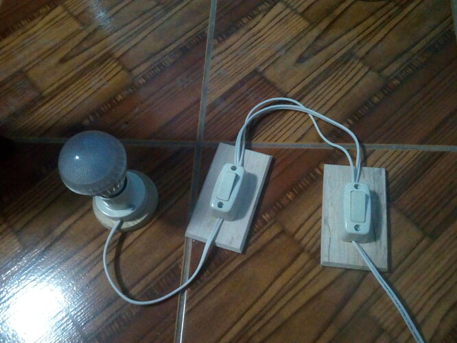

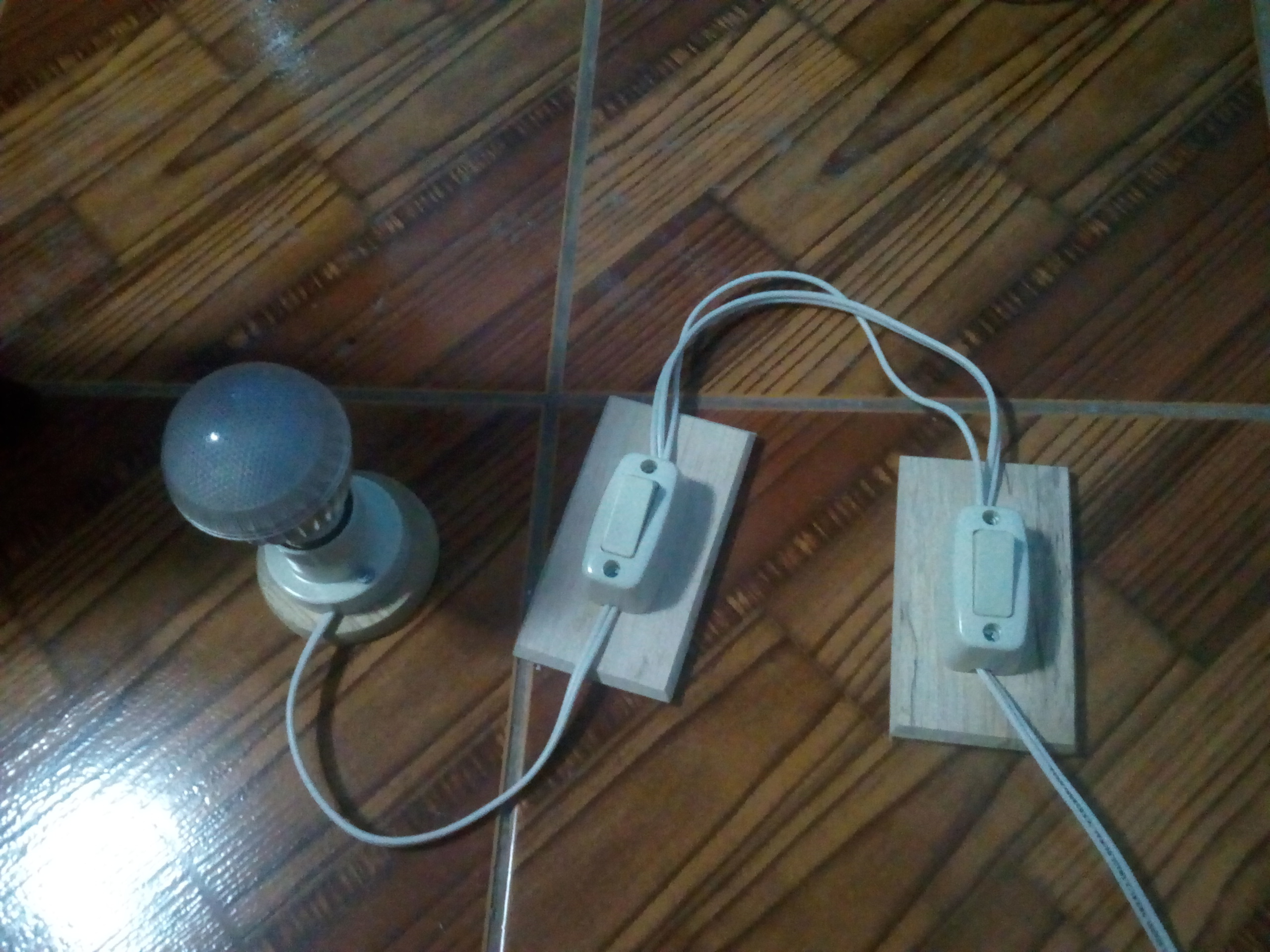

Then, I remembered the concept of conmutation circuit (learned at school, high school), which is mostly used on stairs (2 floors), where it can be switched on and off, either up or down the ladder, independently.

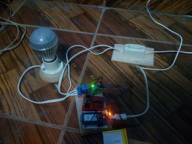

So I thought it would be better to build a switch with arduino (and a relay) but in conmutation mode, next to a traditional switch, so in case the internet fails (and the arduino can not communicate) the traditional switch could continue to operate normally .
And when connected you can work both well, for example you can turn on the physical switch, and turn off with the cloud (an arduino pinout) without needing to know the current state of the switch (to change it)
I hope you understand me, today I just got to operate the electronic part (cloud), during the week I will buy the electric part to be able to build my device with a focus at 220v and can be seen working in a real application (in my house) ![]()
