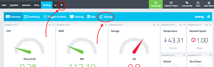

on the cayenne dashboard, there is a plus sign to create a new project. Add the widgets you want to share to this project dashboard and get the sharable link by clicking on sharing
