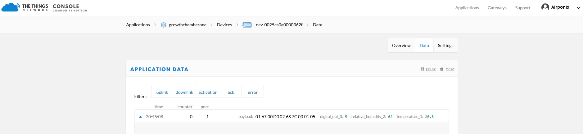

I have a number of Laird RS186 Temperature / Humidity with LoRa / BLE sensors setup via the Things Network. The integration is working nicely. The problem I have is that when I use the provided payload format for the product under /LoRa/ The Things Network/ the temperature and humidity readings are completely wrong (not even just offset). The other values (RSSI and SNR) are correct though. Images attached.
If I use the Cayenne LPP payload format the values seem to be right but then I do not get all the information as above.
Is it possible to check for me please and advise?

it seems your device is sending a cayenne LPP payload. you will need to update it to send Laird payload format. Have a look at section 5 in this https://connectivity-staging.s3.us-east-2.amazonaws.com/s3fs-public/2019-01/Sentrius%20RS1xx%20User%20Guide%20v1_3.pdf

can you try adding the device by selecting cayenne LPP when the device is in cayenne LPP format.
Hi Shramik,
I have done this in parallel as well. What I see is what I described before. Please see screenshots below. Not the same information as per the propriety option. No battery information.
If you want to look at specifics - DevEUI 0025CA0A0000362F
Thanks.
the battery wont show because the cayenneLPP payload the device is sending only temperature humidity and digital output. there is no battery format in it. have a look to the cayenne LPP payload format Cayenne Docs
