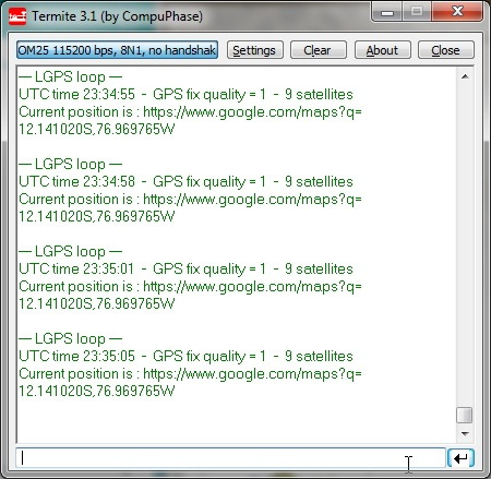

STEP 1: Test GPS with a Base Sketch

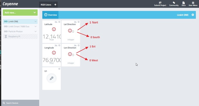

STEP 2: Create Widgets for Virtual Analog Input
As Cayenne will not able to receive letters, we send the directions N/S E/W as values 1/0
Ajust Decimals for Latitude and Longitude (5 is the max)

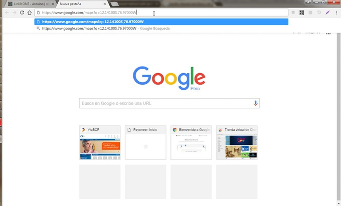

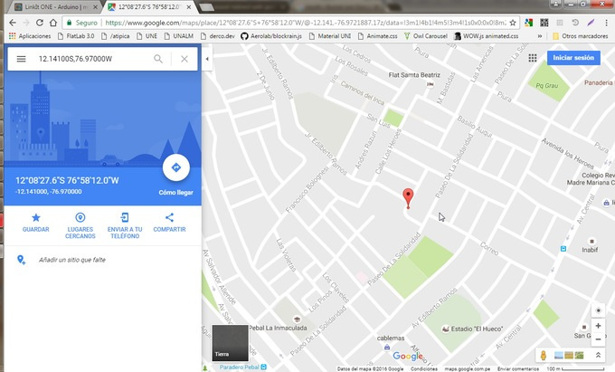

STEP 4: See Values and look for Google Maps Position
As the true value of GPS has 6 decimals and we can only send 5, we get a very approximate position.
