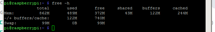

pi@raspberrypi:~ $ free -h
total used free shared buffers cached
Mem: 862M 445M 416M 43M 106M 211M
-/+ buffers/cache: 128M 734M
Swap: 99M 0B 99M
Python3 service is using the most of the ram I think. This does not mean that the constantly growing RAM is from it…
pls what else I can check or monitor?
Can you run free -m to check how much ram you have ?
here you go
