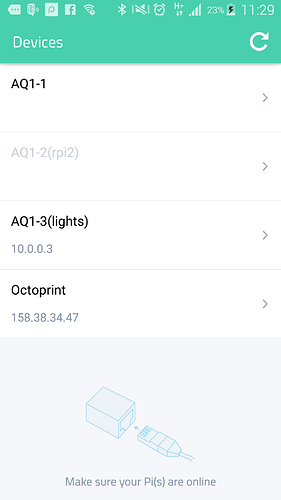

Please describe the bug / issue. Attaching any relevant screenshots would be very helpful!
Often when I try to access my devices on the android app I get a message popping up at the bottom of the screen saying “Disconnected from remote device”, and I can not do anything on the device. But at the same time I’m able to access the device through the web dashboard.
This happens intermittently and completely unpredictably, meaning I have a good internet access and I’m the same network, but sometimes I can’t connect and at other times I get the message “Connected to remote device” and I’m able to control it. When this happens on one device through the app it happens on all devices. So if I can connect to one device I can connect to all, and vice versa. I also get “Server error” when I try to do any configurations on the device when I get the connection error.

@bestes updated to version 1 from the play store yesterday. Today I accessed the app and still get the message “Disconnected from remote device”. Logged into the web dashboard on my computer and everything works fine there, but not from the app.
Also, as you can see from my screenshots, the two devices are on different networks (one getting internet directly from ethernet port), so it can’t be because of the network.
