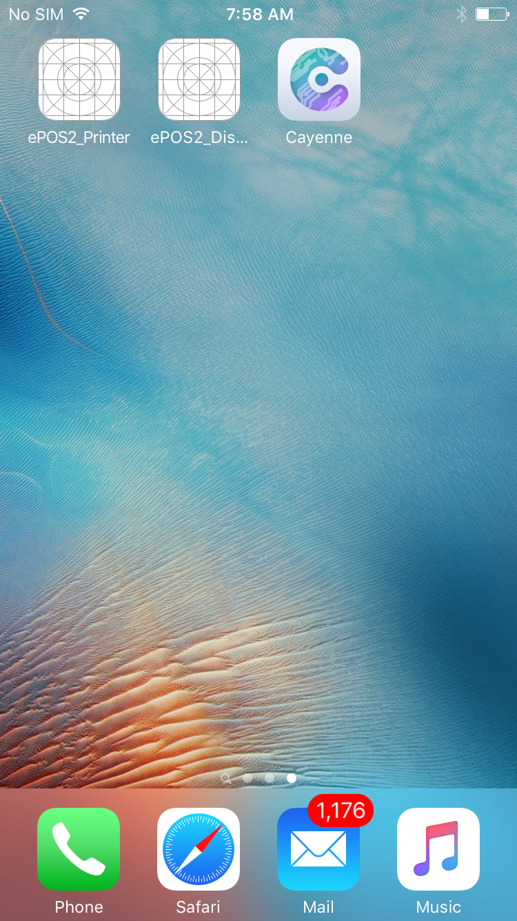

So I think the correct app is the one that is only finding your printers. The Cayenne icon should look like the one in this image.
It seems like the issue with the app is that your Pi is not getting discovered using the app discovery technology…it seems like only your printers are getting discovered. We’ve had issues where, for whatever reason, the Pi sometimes cannot get discovered on the network. Could be due to the old Model B+ you are using, or some configuration on the network.
However, once you create your account through the web dashboard and add your Pi, if you log into the same account on the app then the Pi that you’ve add through the web dashboard should appear in the app without the need to actually discover it on the network. Just to be sure, I don’t think it would hurt to uninstall the Cayenne app and then reinstall it and sign into the same account that has the Pi added from the web dashboard.
