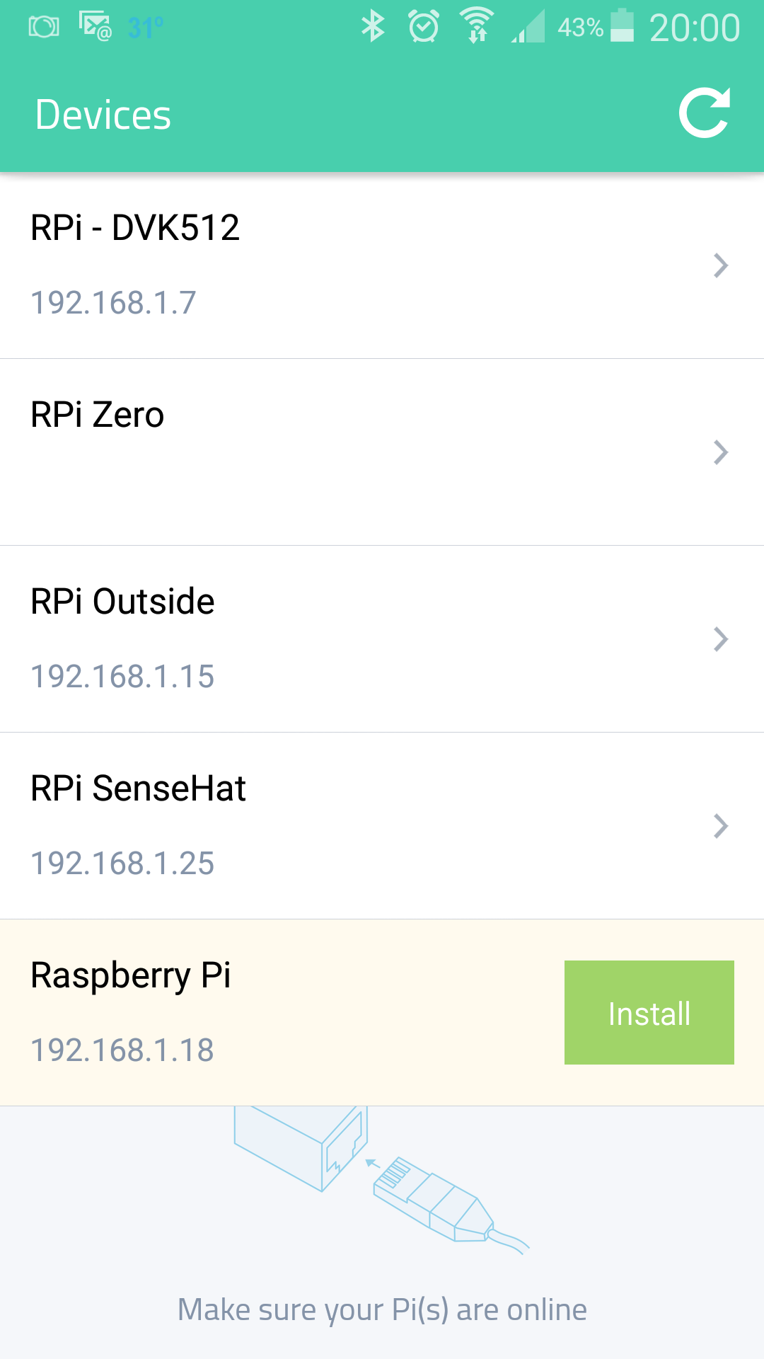

The Android process is a little more strait forward. When you start the app it should recognize a new RPi on your network, if you don’t see the new RPi try hitting the reload button in the upper right corner-
